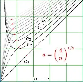

A picture says more than a thousand words. Successive iterands must be read from the bottom to the top, following e.g. one of the vertical green lines:
Thirteen functions $a_k(a)$ with $k = 1,2,\cdots ,13$ are displayed; lower iterands with darker lines.
The viewport is:
xmin = 0; xmax = 5; ymin = 0; ymax = 5;
Let's make a few calculations, for the sake of understanding the graphics: $$ a_1(a) = a\\ a_2(a) = \frac{a^2+1}{a}\\ a_3(a) = \frac{a(a^2+3)}{a^2+1}\\ a_4(a) = \frac{a^4+6a^2+3}{a(a^2+3)}\\ a_5(a) = \frac{a(a^4+10a^2+15)}{a^4+6a^2+3} $$ That's enough to see the folowing fact:

It is seen that the curves [ $a_2(a)$ and $a_3(a)$ ] , [ $a_4(a)$ and $a_5(a)$ ] , [ $a_6(a)$ and $a_7(a)$ ] , in general
[ $a_{even}(a)$ and $a_{even+1/odd}(a)$ ] each have an intersection point. For [ $a_2(a)$ and $a_3(a)$ ] this point is easy to find: $$ a + \frac{1}{a} = a + \frac{2}{a + \frac{1}{a}} \quad \Longrightarrow \quad 2a = a + \frac{1}{a} \\ \Longrightarrow \quad (a,a_2(a))=(a,a_3(a))=(1,2) $$ But if we want to find some other intersection points, considerable difficulties cross our path; even the help of a computer algebra system (like MAPLE) seems to be futile, with exact solutions.
So let's take a look instead at the ingenious conjecture as proposed by the OP: $$ n > \frac{4}{a^3} \quad \Longrightarrow \quad a > \left(\frac{4}{n}\right)^{1/3} $$ These values $a$ together with their function values $a_k(a)$ are displayed as red dots in the picture.
It is clearly seen that the conjecture is quite good, especially for larger values of $n$.
It is an approximation, though, and a sufficient condition at best, not a necessary condition.
But in order to formulate a sufficient and necessary condition, the above mentioned intersection points must be found, which seems at this moment a too hard task to accomplish.
EDIT. In order to solve for the points of intersection, equate $a_{n+1}$ to $a_n$ , noticing that $a_n > 0$ : $$ a_n = a_{n+1} = a + \frac{n}{a_n} \quad \Longrightarrow \quad a_n^2-a\cdot a_n-n = 0 \quad \Longrightarrow \quad a_n = \frac{a}{2} + \sqrt{\left(\frac{a}{2}\right)^2+n} $$ So now we know the ordinates of the intersection points. But, unfortunately, that doesn't give us any information about the abscissas $a$. What we can do is draw the $\color{blue}{\mbox{graphs}}$ of the new functions, name them $b_n(a)$ :
We expect that $b_n(a) = a_n(a) = a_{n+1}(a)$ at the intersection points. However, there is a difference between the curves in dark Blue and light blue (Aqua). The former are for $b_n(a)$ with $n = $ even; they intersect $a_n(a)$ and $a_{n+1}(a)$ as expected. The latter are for $b_n(a)$ with $n = $ odd; they do not intersect $a_n(a)$ and $a_{n+1}(a)$. But all blue curves $b_n(a)$ are somehow interesting, because they are asymptotes to the curves $a_n(a)$. For large values of $a$ we have almost straight lines: $$ b_n(a) = \frac{a}{2}+\frac{a}{2}\sqrt{1+\frac{n}{(a/2)^2}} \approx a + \frac{n}{a} $$ Still another way to calculate the intersection points is to determine the minimum of the curves $a_n(a)$ for $n = $ even. Which is easy to prove, because $a_n(a)\ne a/2$ in : $$ a_n^2(a)-a\cdot a_n(a)-n = 0 \quad \Longrightarrow \quad a_n'(a)\left[2 a_n(a)-a\right]= 0 \quad \Longrightarrow \quad a_n'(a)=0 $$ The slope of the accompanying odd curve at such a minimum is always $1$ , according to: $$ a_{n+1}'(a) = \left(a-\frac{n}{a_n(a)}\right)' = 1-\frac{n\, a_n'(a)}{a_n^2(a)} = 1 $$ Let's do some work with help of MAPLE:
