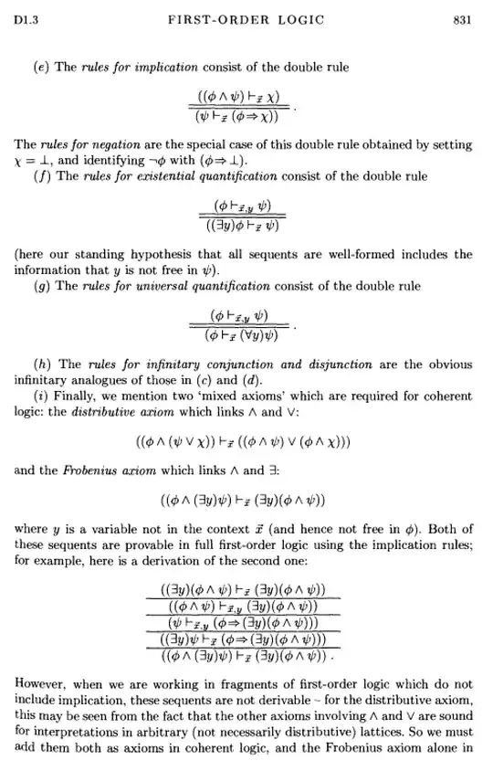

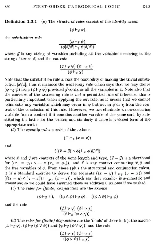

It feels trivial but I don't find any suitable rules to derive it. For reference by rules I mean the following (I just don't find anything that allows me to deduct a sequent containing $\exists y$ that appears on the right of $\vdash$):

1) $(∃y)(\phi \land (y=x)) ⊢_x (∃y)(\phi \land (y=x))$ --- identity axiom
2) $\phi \land (y=x) ⊢_{x,y} (∃y)(\phi \land (y=x))$ --- rule for existential quantification
3) $\phi[x/y] \land (x=x) ⊢_x (∃y)(\phi \land (y=x))$ --- with substitution $[x/y]$.
4) $\phi[x/y] \vdash_x \phi[x/y]$ --- identity axiom
5) $\phi[x/y] \vdash_x \top$ --- rule for (finite) conjunction
6) $\top \vdash_x (x=x)$ --- equality rule
7) $\phi[x/y] \vdash_x (x=x)$ --- from 5) and 6) by cut rule
8) $\phi[x/y] \vdash \phi[x/y] \land (x=x)$ --- from 4) and 7) by rule for (finite) conjunction
$\phi[x/y] \vdash_x (∃y)(\phi \land (y=x))$ --- from 3) and 8) by cut rule.

    Thanks for the response. Someone helped me on another place. So if we write $\psi(\vec{y})$ for $(\phi\land\left(\vec{y} = \vec{x}\right))$ then we can go from $(\exists\vec{y})\psi\vdash_{\vec{x}}(\exists\vec{y})\psi$ to $\psi\vdash_{\vec{x}, \vec{y}}(\exists\vec{y})\psi$ by (f), and then make a subsitution $[\vec{y}/\vec{x}]$, to get $\psi[\vec{y}/\vec{x}]\vdash_{\vec{x}, \vec{y}}(\exists\vec{y})\psi$, which is just $\phi\left[\vec{x}\left/\vec{y}\right.\right]\land\top\vdash_{\vec{x}}\left(\exists \vec{y}\right)\left(\phi\land\left(\vec{y} = \vec{x}\right)\right)$. Q.E.D. – h__ Jan 05 '17 at 18:51
  • @MauroALLEGRANZA for conjunction, isn't that included in (c)? – h__ Jan 06 '17 at 01:16
