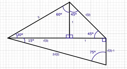

$\text{What is the ratio of legs in a right triangle with angles of 15, 75, and 90?}$ I know the ratio of legs in a $30, 60, 90$ triangle, which is the lengths $1$, $\sqrt{3}$, and $2$ respectively. This is what I have got so far: Using the 30-60-90 Ratio
How would I be able to take this a step further and be able to find the answer? Thanks in advance.
6 Answers6

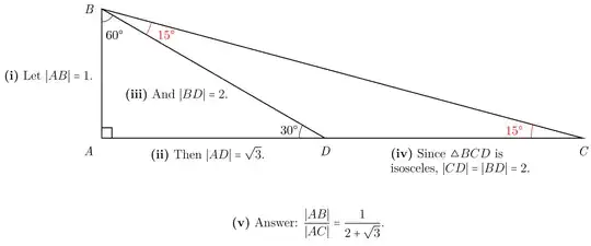

The ratio of legs is $$ r = \tan 15^\circ. $$ (This is quite easily derived from the definition of the $\tan$ function.)
You can also represent the ratio using radicals: $$ r = 2 - \sqrt{3} \approx 0.267949 $$
If we do not want to use $\tan$ at all, then we obtain the same answer just reasoning from your picture: $$ r = {1\over2+\sqrt{3}}= 2 - \sqrt{3}. $$
(In this ratio, the numerator $1$ is the vertical leg in your picture; and the denominator $2+\sqrt{3}$ is the horizontal leg.)
Alex
  • 4,973
    And I might add: That is a very well-reasoned picture, and good thinking to come up with that answer without any reference to trigonometry. – Wildcard Jan 03 '17 at 23:38
  • Yes. On the other hand, the picture is a nice and easy way to explain why $\tan 15^\circ$ equals $2-\sqrt3$ exactly. – Alex Jan 03 '17 at 23:43
    @Alex Thanks a lot for this and I liked how you actually proved that the tan 15 $= 2-\sqrt{3}$. :) – Ojasw Upadhyay Jan 05 '17 at 17:38

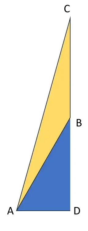

$\triangle ABD$ has a right angle at $D$ and acute angles of $30°(B)$ and $60°(A)$. $\triangle ABC$ is isosceles with base $\overline{AC}$. Thus with the dimensions of the $30°-60°-90°$ right triangle, $BC=AB=2AD$ and $BD=\sqrt3AD$. Also $\angle ACD$ in the isosceles triangle measures half the exterior $\angle ABD$, thus $15°$. Thereby $\triangle ACD$ is a right triangle with acute angles measuring $15°$ and $75°$, with $\color{blue}{CD=BC+BD=(2+\sqrt3)AD}$.
Oscar Lanzi
  • 48,208

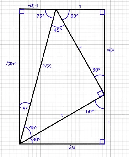

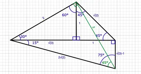

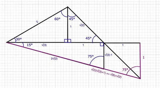

Using the 30/60/90 triangle you can derive the others by creating a rectangle of triangles.
You can also se this relationship if you want to keep the 45-45-90 as the standard ratio.
Either way the 2x 45-45-90 triangle still there for reference:
Adding an additional view if you want to see a ratio where at least one of the side is 1 for the 15-75-90 triangle
masters3d
  • 121
