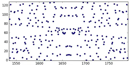

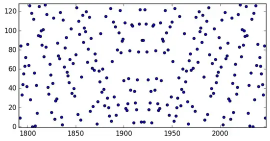

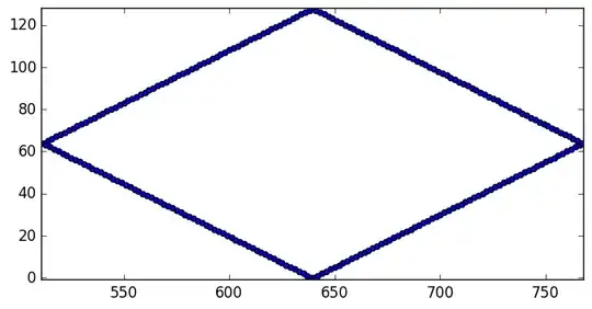

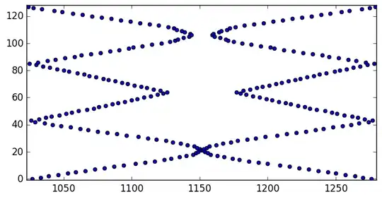

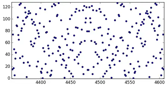

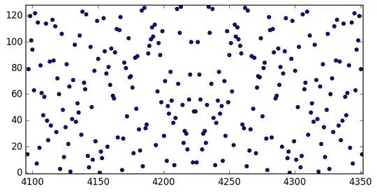

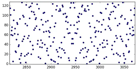

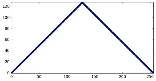

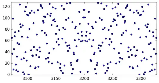

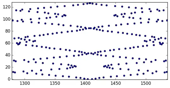

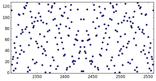

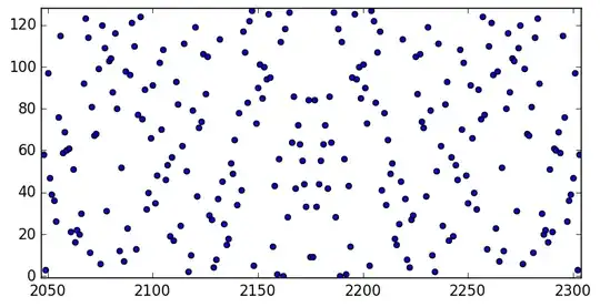

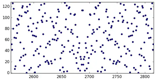

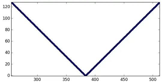

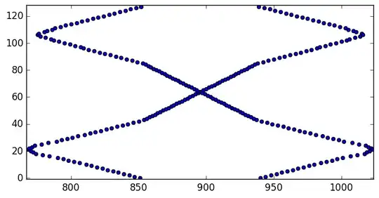

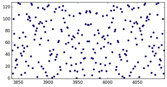

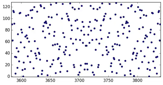

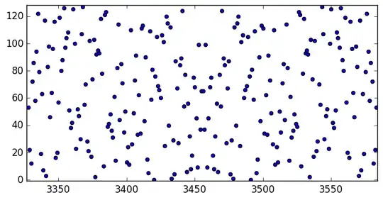

EDIT: I tried plotting what happens for a large number of players $n$. Unfortunately I can't check with sufficient resolution but I conjecture that, as $n$ approaches $\infty$, each subset of $2n$ turns (excluding turns in previous subsets, so the set of turns $0\dots 2n-1$, $2n\dots 4n-1$, etc.) gives a (in the player limit) continuous boundary that ought to likely look fractal. (in the limit of turns $2n + i | i \in \left\{0\dots 2n-1 \right\} , n \to \infty$)
With the code as stated I fairly quickly run into memory problems, but here are the first few thousand turns that my computer could handle.
Note how each image is mirror symmetric. This is true for every $2n$ turns with $n$ players. To get much farther (more players, more turns) I need a more efficient approach.
$128$ players, moves $0 - 4607$, in chunks of $256 \ (= 2\times 128)$ moves each. Horizontal axis denotes turn, vertical the player ID (labelled from $0-127$).
(There is no text past these images.)
