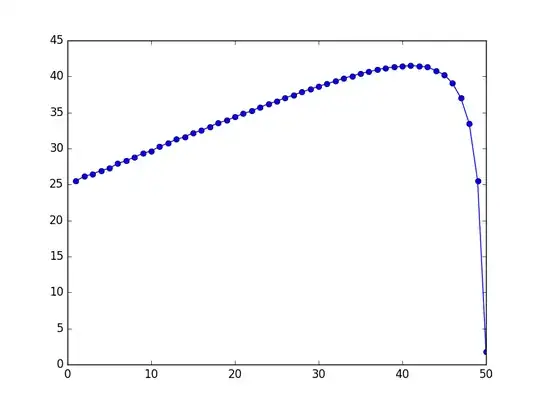

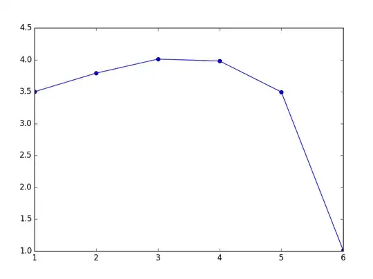

In case you wanted some evidence, here are the graphs of average money earned after stopping as soon as a roll of $x$ or higher is seen.
$n = 6$. Note how the optimal value is when $x = 3$ or $x = 4$ are the cutoffs:
$n = 50$. Note how max is at $51 - \sqrt{100} = 41$, exactly as the formula predicts:
