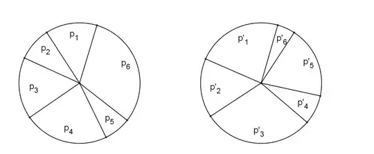

In the same vein as the example of @JimmyK4542, although different.
Is it possible that the sum of the outcomes of two "flawed" dices with usual numbers $\{1,2, \cdots 6\}$ on their sides has a uniform distribution on $\{2, \cdots 12\}$ ? The answer is negative.
Proof: We should have, with evident notations
$$\tag{1}(p_1x+p_2x^2+\cdots p_6x^6)(p'_1x+p'_2x^2+\cdots p'_6x^6)=\frac{1}{11}(x^2+x^3+\cdots x^{12})$$
Factoring $x^2$, $(1)$ is equivalent to:
$$\tag{2}(p_1+p_2x+\cdots p_6x^5)(p'_1+p'_2x+\cdots p'_6x^5)=\frac{1}{11}(1+x+\cdots x^{10})$$
But this is impossible because
  • on the LHS of $(2)$, we have the product of two odd degree polynomials, each one having at least one real root, whereas
  • the roots of the polynomial in the RHS, which can be written under the form $\frac{1-x^{11}}{1-x}$, are the $e^{2i\pi k/11}$, k=1..10$, with no real root among them. Contradiction.
Remark: insted of "flawed dices", it is probably better to give a context of two "roulettes" with unequal sectors as represented on the graphics below: enter image description here
