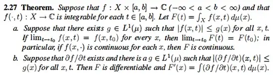

Your thoughts are essentially from a theorem (2.27b) in Folland's Real Analysis:
A simple calculation shows that $$ \biggr|\frac{\partial}{\partial a}\left[\frac{\log(1+ax)}{1+x^2}\right]\biggr|= \biggr|\frac{x}{1+x^2}\frac{1}{1+ax}\biggr|\leq 1 $$ for $(x,a)\in[0,1]\times[0.5,1.5]$. Thus one can let $g(x)=1$ on $[0,1]$ as the dominated function.
