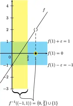

We show how the guessing of the right $\delta>0$ may fail at discontinuities by a slight modification of the OP's example: \begin{align*} f(x) :=\begin{cases} 3x-1&@x\neq 1\\ 0 &@ x=1 \end{cases} \end{align*} We assume that $f$ would be continuous at $x=1$. Let $\varepsilon>0$ be arbitrarily (small). Searching for an appropriate $\delta>0$ with $|f(x)-f(1)|<\epsilon$ for all $|x-1|<\delta$ we determine the pre-image of the $\varepsilon$-neighborhood $(-\varepsilon,\varepsilon)$ of $f(1)=0$: \begin{align*} \{x\in\mathbb{R}:\,|f(x)-f(1)|<\varepsilon\} &= \underbrace{\{1\}}_{\text{for }f(x)=0}\cup \{x\in\mathbb{R}\setminus\{1\}:\,|3x-1|<\epsilon\}\\ &=\{1\} \cup \left(\frac{1-\varepsilon}3,\frac{1+\varepsilon}3\right) \end{align*} Starting from $\varepsilon=2$ the open interval $\left(\frac{1-\varepsilon}3,\frac{1+\varepsilon}3\right)$ becomes disconnected to the location $x=1$ for shrinking $\varepsilon$. So the argument $x=1$ which maps into the open $\varepsilon$-neighborhood of $f(1)$ becomes insulated in the pre-image of this neighborhood. The pre-image is not a neighborhood of $x=1$ and therefore does not contain the interval $(1-\delta,1+\delta)$ for any $\delta>0$.
The following figure shows the pre-image of $(f(1)-\varepsilon,f(1)+\varepsilon)$ for $\varepsilon=1$, i.e., $f^{-1}((-1,1))=\{x\in\mathbb{R}:\, -1<f(x)<1\}$. We take $\varepsilon=1$ instead of $\varepsilon=2$ to make the insulation of $x=1$ in the pre-image of $(f(1)-\varepsilon,f(1)+\varepsilon)$ more visible. The broken circle ( ) at $(x,y)=(1,2)$ indicates that there is a gap in the linear graph at $x=1$. This gap is filled by $(x,y)=(1,0)$ as it is indicated by the bullet &bullet; there.
The blue strip indicates the y-interval $(-1,1)$ which is mapped to the pre-image $f^{-1}((-1,1))$ which is colored yellow. We take special note of the yellow ring around the bullet at $(x,y)=(1,0)$ which is the indicates point of the pre-image.
There is no room around this point for a $\delta$-interval.
Preimage of function f
