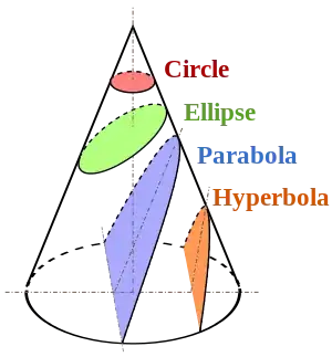

Circles and parabolas are both second degree equations, meaning that they can be created by cutting open a cone (conic sections): (You could also make these by shining a flashlight)
This is related to eccentricity.
You could imagine eccentricity to be how much these graphs are stretched: ($e=$ eccentricity)
circle: $e=0$
ellipse: $0<e<1$
parabola: $e=1$
hyperbola: $e>1$

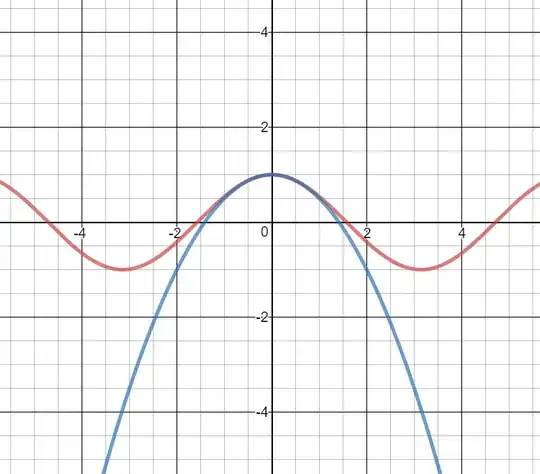

while probably not what you were thinking of, sinusoidal functions look parabolic locally:
which is due to Taylor's theorem.

  • A circle with the appropriate center and radius, superimposed on the graph that shows the local similarity of the sine curve and parabola, will also match the sine and parabola closely for small values of $x,$ for the same reason that the other two match closely there. – David K Dec 23 '16 at 20:36

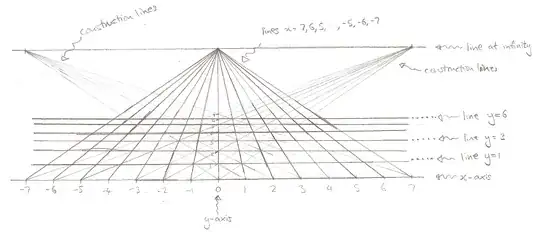

So far, what I've said about the projective plane is just hand-wavy algebra. But projective geometry really stems from trying to draw the world around us: we see the world in perspective, resulting in certain projective features in our vision.
For example, one can imagine that if we lived on a perfectly flat plane that extended infinitely in all directions, then the railroad tracks in this image would appear to meet at the horizon (they don't in the image due to the curvature of the Earth, but a plane has curvature zero, thereby removing that problem). But they're railroad tracks, so they must be parallel - parallel lines that "meet somewhere". The reason they would appear to meet at the horizon is that we would be seeing the projective plane around us, wherein the horizon line would be the line at infinity. This at least makes some intuitive sense: if you're standing on an infinite plane, and you still see a horizon (which you must do if, say, the ground is green and the sky is blue), then the horizon must be infinitely far away: the line at infinity. Moreover, the railroad tracks are parallel lines, so they must meet at a unique point on the line at infinity, i.e., at some point on the horizon.
Now, we can put coordinates on our projective plane: put coordinates on the usual Cartesian (or affine) plane and then imagine that you're standing at $(0,-1),$ looking straight up the $y$-axis. We get something like this:
Hopefully you can fill in the rest of the coordinate system with your imagination. Note that the "vertical" lines $x=7,6,5,\ldots,-5,-6,-7$ are parallel, and hence all meet at the same point on the horizon.

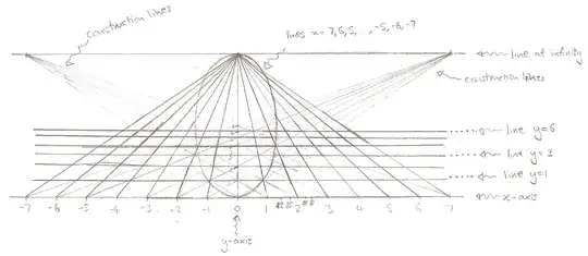

We can sketch the parabola $y=x^{2}$ on such a coordinate system. Here's what we get:
At this point (if my freehand drawing skills are good enough), you might be thinking "Will, that's not a parabola, that's an ellipse" (and if you aren't thinking that, then I need to improve). Indeed, I have more-or-less drawn an ellipse, but you even know in advance that it can't be an ellipse in the usual sense, because it meets the line at infinity.
So you see that, projectively, parabolas and ellipses are at least related, even if you aren't convinced they're the same. With an additional helping of mathematical formalism (which would take a good few hours of lectures to properly explain) one can make everything I've said so far completely rigorous, work in "homogeneous coordinates" and actually write down "projective changes of coordinates", that keep the underlying geometric objects the same (at least, projectively the same) but transform the corresponding polynomial equations into each other, and it turns out that there is indeed a projective change of coordinates that transforms $x^{2}+y^{2}=1$ into $y=x^{2}.$
So, from a projective standpoint, circular and parabolic paths aren't all that different. If you're travelling along a parabola in the projective plane, and if you experience time projectively as well, i.e., that your path is parametrized by $t\in\mathbb{RP}^{1}$ (the projective line with its own "point at infinity"), then you will "eventually" get back to where you started, just as if you were travelling along a circle the whole time (because, projectively, you were).

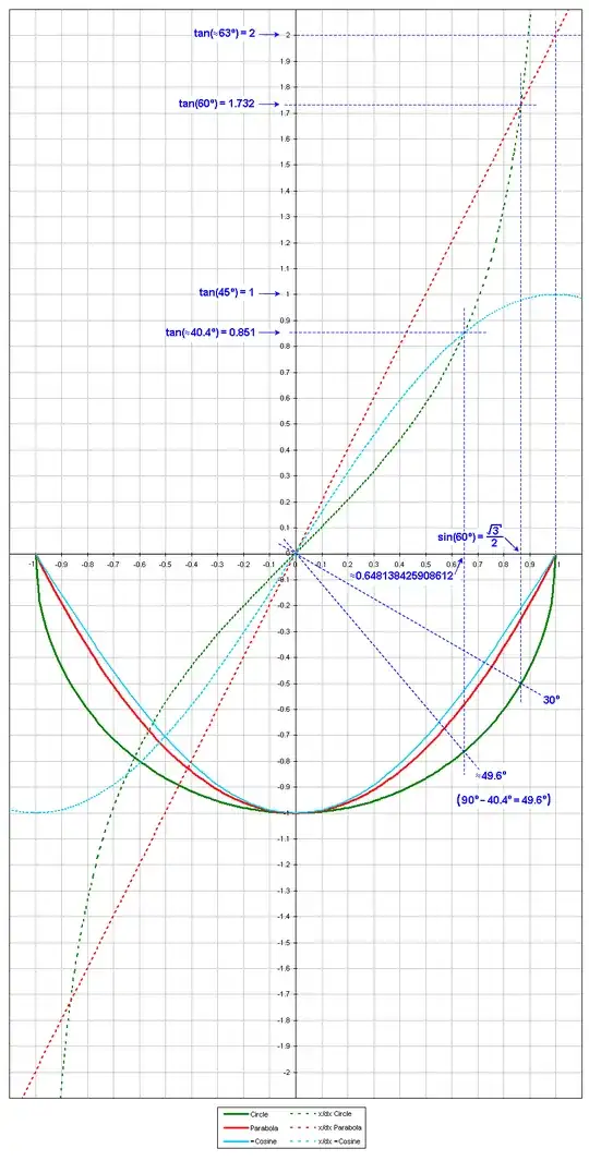

The Circles and Parabolas are related as conic sections. If you take a normalized Semicircle and graph it together with a normalized Parabola shifted down by -1, then the Parabola will fit INSIDE the Semicircle within the -1≥x≥1 domain, and have 3 common points with the Semicircle at (0,-1) and (-1,0) and (+1,0). The same can be done with a normalized negative Cosine curve - it will fit inside both the Parabola and Semicircle, within the -1≥x≥1 domain and have the same 3 common points with the other two curves.
The graph of first derivatives (x/dx) of the Semicircle, Parabola and the Cosine curve, depicts the slopes, that these curves have at a given X coordinate with respect to the horizontal X axis. You correctly noticed, that the slope of the Semicircle becomes vertical (90º) at its ends (the x/dx derivative of the Semicircle becomes infinite when Y = 0), however the arms of the Parabola assume the slope angle of ±63º (rounded down) at the same coordinates. The Cosine curve's slope angle is ±45º at these coordinates.
Trivially, all of the slopes of these 3 curves are equal (to 0º) when the X coordinate is 0. Besides this, you can also see, that the slopes of the Semicircle and Parabola become equal (both = ±60º) at the ±(√3/2) X coordinate, which on the Semicircle is ±30º from the the horizontal X axis and the slope of the Cosine curve equals the slope of the Semicircle at the ±0.648138425908612 X coordinate, where both curves assume the slope of approximately ±40.4º (on the semicircle this slope appears approximately ±49.6º from the the horizontal X axis, because 90º-40.4º=49.6º). Calculation of this non-trivial slope equality between the Cosine curve and the Semicircle, can be done ONLY NUMERICALLY, which is an indicator that the Cosine curve is a different type of curve. Besides the trivial case at X=0, the slope of the normalized Cosine curve never equals the slope of the normalized Parabola for the same X coordinate within the -1≥x≥1 domain.
Finally, the curvatures of the Semicircle and Parabola are equal only at their apexes, that is at the (0,-1) point on the graph.

It is possible to analyze other curving functions the same way. For example, the normalized Hyperbolic Cosine (shifted down by -2), will have the same 3 points common with the Semicircle, Parabola and the Cosine curve in the -1≥x≥1 domain, but it will fit between the Semicircle and the Parabola (the cosh() matches the Parabola better than -cos()) and the ends of its arms will have a ±60º slope when Y=0. The slope of the Hyperbolic Cosine is equal to the slopes of the Semicircle or the Cosine Curve at some X coordinate, but is never equal to the slope of the Parabola in the -1≥x≥1 domain, besides the trivial case at X=0. I am not including the cosh() on the graph, because the OP did not ask about it.

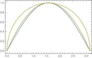

Are sinusoidal graphs connected semi-circles or parabolas?
I hope you are not under the impression that these are the only possibilities. There are many different possible curves, infinitely many in fact, parabolas and semi-circles are only 2 examples. The sine curve is neither piecewise parabolical, nor piecewise semicircular. It is a different curve altogether.
The figure below contains a sine function, a parabola and a semicircle, all passing through $(0,0)$, $(\pi/2,1)$ and $(\pi,0)$. You can see that they are indeed distinct.
Half a period of the sine function, a parabola and a semicircle
