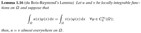

If, additionally, $u\in H^2(\Lambda)$ and $\Lambda$ is bounded with Lipschitz boundary, then (Corollary 3.46 here) $$\int_\Lambda (-\Delta u) \varphi\;\mathrm{d}\lambda=-\int_\Lambda u\Delta \varphi\;\mathrm{d}\lambda=\int_\Lambda f \varphi\;\mathrm{d}\lambda.$$ Therefore by the Du Bois Reymond Lemma (Lema 1.16 here) $$-\Delta u=f\quad\text{a.e.}$$

    @0xbadf00d We need $u$ and $\Lambda$ regular enough so that we can apply integration by parts and the Du Bois Reymond Lemma. For the first, the basic assumptions are $u\in H^2(\Lambda)$ and $\Lambda$ bounded with Lipschitz boundary (see Corollary 3.46 here); for the second, the basic assumptions are $\Lambda$ open and $u$ locally integrable (see Lema 1.16 here). As the Du Bois-Reymond Lemma is very general, the key point is the needed assumptions for the integration by parts. See the edit in my answer. No, I didn't exploit the said embedding. – Pedro Dec 21 '16 at 23:01
