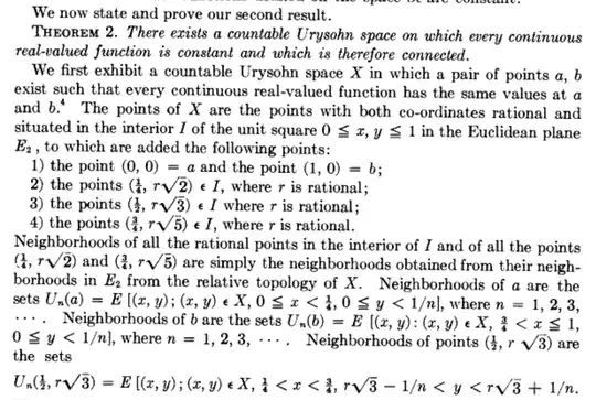

You can see this paper by Edwin Hewitt, where it is proved that for every cardinal number $\aleph$ which is not the sum of $\aleph_0$ cardinal numbers less than $\aleph$, there exists a Hausdorff space $X$ with $|X|=\aleph$ such that every continuous real function on $X$ is constant.
Some examples by Urysohn and Pospišil are mentioned.
Theorem 2 in the paper by Hewitt exhibits a countable Hausdorff space on which every continuous real function is constant. The construction is due to R. F. Arens.
  1. Edwin Hewitt, On two problems of Urysohn, Annals of Mathematics Second Series, Vol. 47, No. 3 (Jul., 1946), pp. 503–509
