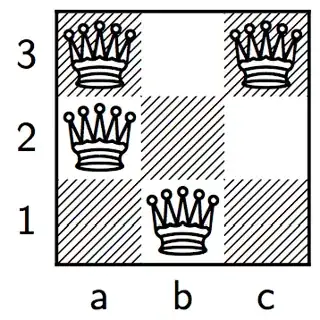

A $3 \times 3$ board can host 17 moves: (The queen at a3 has three moves, the queen at a2 has four moves, and the queens at b1 and c3 each have five moves.)
Optimal configuration on 3x3 board

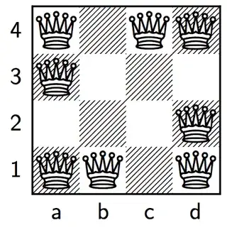

A $4 \times 4$ board can host 40 moves:
Optimal configuration on 4x4 board

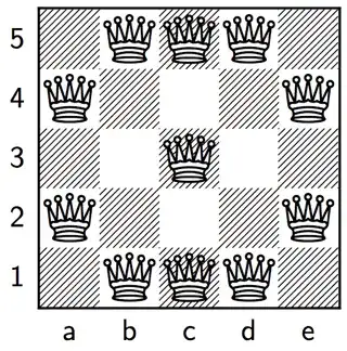

And a $5 \times 5$ board can host 76 moves:
Optimal configuration on 5x5 board

It's worth noting that although 40 moves is indeed the maximal solution for the 4×4 board, it can be achieved with only 6 Queens (it is also achievable with 7 and 8 Queens).
