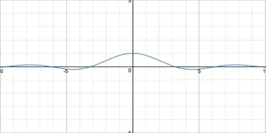

Consider the function $f(x)=\frac{\sin x}{x}$. A graph of $f(x)$ might look like:
Graph of f(x)
It seems that $f(0)=1$, but $f(0)=\frac{\sin 0}{0}=\frac{0}{0}$. Thus, $f(x)$ has an undefined point at $x=0$ - it is an $\frac{0}{0}$ indeterminate form!
Some indeterminate forms will not have a limit. For example,
$$\lim_{x\to 0}\frac{1}{x}$$
is undefined: it diverges to $\infty$ from the positive direction and $-\infty$ from the negative direction. But $\displaystyle\lim_{x\to 0}f(x)$ seems to be $1$. Indeed, this limit is shown here:
How to prove that $\lim\limits_{x\to0}\frac{\sin x}x=1$?
Although this particular function required no algebraic manipulation, clearly more complicated functions would require it.
