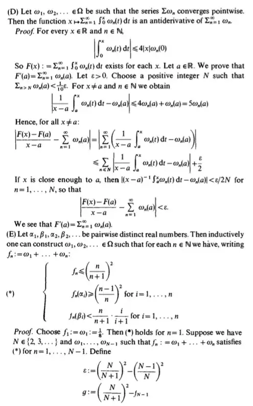

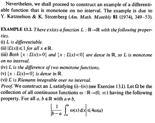

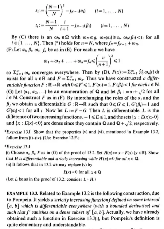

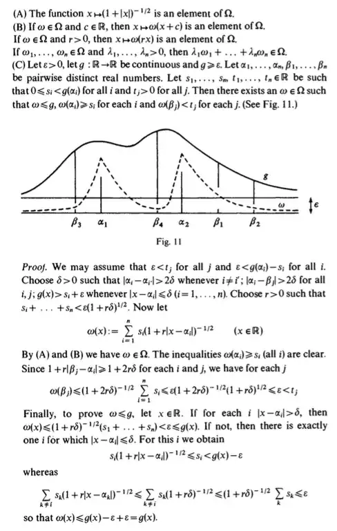

A non-constant function $f$ with the required properties is given as Exercise 13.J in A. C. M. van Rooij, W. H. Schikhof, A Second Course on Real Functions, based on an example due to Y. Katznelson and Karl Stromberg, in Everywhere differentiable, nowhere monotone, functions, Amer. Math. Monthly 81 (1974), 349–354, jstor.
Here is a copy of the example:

1@Dominik : I agree, this doesn't need to be the case. But the example given in A. C. M. van Rooij, W. H. Schikhof exactly satisfies the condition $f'(x) = 0$ for all rational $x$. – Watson Dec 01 '16 at 16:43
