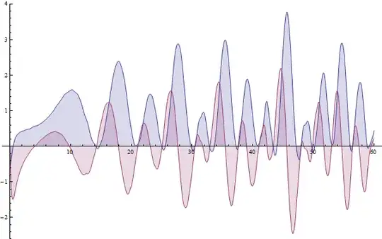

Plot 1: Real and imaginary parts of the discrete Fourier like transform of exponential sawtooth waves, times some number $a$ as a scale factor. Fourier like transform of exponential sawtooth waves times scale factor

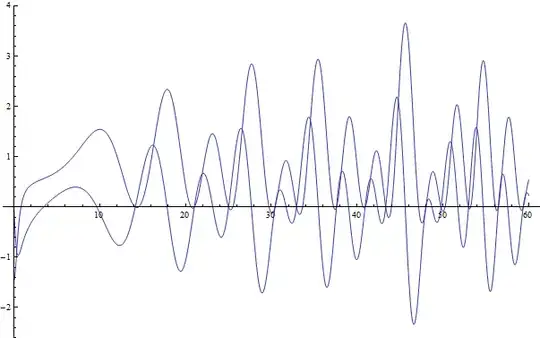

Plot2: Real and imaginary parts of the Riemann zeta function on the critical line. The Riemann zeta function on the critical line

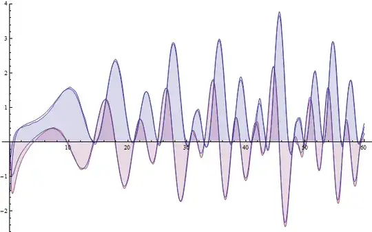

Plot3: The two plots above superimposed. The two plots above superimposed
The Mathematica program for the plots is:
NN = 1000000;
xres = .002;
x = Exp[Range[0, Log[NN], xres]];
tmax = 60;
tres = .060;
Monitor[errList1 =
   Table[Total[((x^(-1/2 + I t)*(SawtoothWave[x] - 1)))]*(1/2 +
       I t), {t, Range[0, tmax, tres]}];, t]
Monitor[errList2 =
   Table[Total[((x^(-1/2 + I t)*(SawtoothWave[x] + 0)))]*(1/2 +
g1 = ListLinePlot[
   14.134725141734693790*{Re[errList1]/Length[x], -Im[errList2]/Length[x]},
   DataRange -> {0, tmax}, Axes -> True, PlotRange -> {-2.6, 4},
   ImageSize -> Full, Filling -> Axis];
g2 = Plot[Re[Zeta[1/2 + I t]], {t, 0, tmax}, PlotRange -> {-2.6, 4},
ImageSize -> Full];
g3 = Plot[Im[Zeta[1/2 + I t]], {t, 0, tmax}, PlotRange -> {-2.6, 4},
   ImageSize -> Full];
Print["Real and imaginary parts of the discrete Fourier transform \
like plot of exponential sawtooth waves, times some number as a scale \
factor"]
Show[g1]
Print["Real and imaginary parts of the Riemann zeta function on the \
critical line"]
Show[g2, g3]
Print["The two plots above superimposed"]
Show[g1, g2, g3]
In the program the scale factor happens to be close to the first Riemann zeta zero, but this is not true since changing the parameter "NN" requires a different scale factor. I apologize if the plots are a bit oversized.

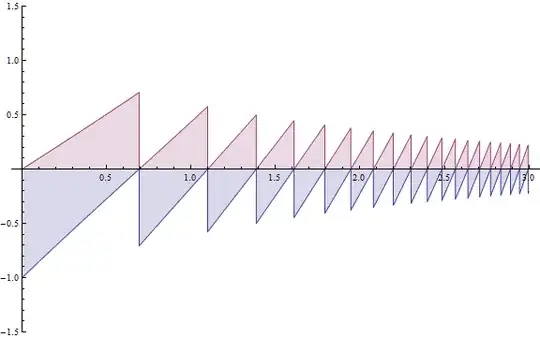

Plots of the sawtooth waves for Real and Imaginary parts:
logarithmicSquarerootSawtoothwaves
Also, changed the +1 in the formulas to +0 after some exerimenting and consideration.

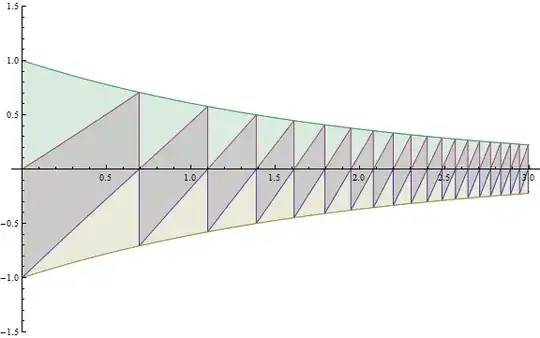

Plots of differences of the sawtooth waves for Real and Imaginary parts:
DifferencesOfLogarithmicSquarerootSawtoothwaves
This lower plot was generated with the Mathematica code below:
scale = 1000000;
xres = .00001;
x = Exp[Range[0, Log[scale], xres]];
RealPart = (SawtoothWave[x] - 1)*
  x^(-1/2); ImaginaryPart = (SawtoothWave[x] + 0)*x^(-1/2);
SumOfPartsReMinusIm = RealPart - ImaginaryPart;
SumOfPartsImMinusRe = -RealPart + ImaginaryPart;
datapointsdisplayed = 300000;
ymin = -1.5;
ymax = 1.5; g1 =
 ListLinePlot[{RealPart[[1 ;; datapointsdisplayed]],
   ImaginaryPart[[1 ;; datapointsdisplayed]],
   SumOfPartsReMinusIm[[1 ;; datapointsdisplayed]],
   SumOfPartsImMinusRe[[1 ;; datapointsdisplayed]]},
  PlotRange -> {ymin, ymax},
  DataRange -> {0, xres*datapointsdisplayed}, Filling -> Axis];
Show[g1, ImageSize -> Large]
