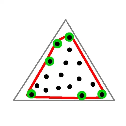

I am distributing points uniformly within an equilateral triangle:
I would like to make a guess, for any given number of distributed points, how many of those points on average will be on the convex hull (points outlined green on the diagram).
I'm hoping to avoid writing a program to empirically plot and measure the mean number of points on the convex hull for each number of distributed points - perhaps someone has already proposed a general method for estimating this value?

    Preparata & Shamos report the pretty precise result from http://link.springer.com/article/10.1007%2FBF00535300?LI=true $E(h)=2r/3(\gamma+\ln N)+O(1)$ for a convex $r$-gon. –  Nov 22 '16 at 20:09
  • Where $\gamma$ is Euler's constant, I suppose. Very interesting. – Jean Marie Nov 22 '16 at 20:11
  • Yep, that's it . –  Nov 22 '16 at 20:12
For triangle, $E_n = 2H_{n-1}$ where $H_{n-1} = \sum\limits_{k=1}^{n-1} \frac{1}{k}$ is the $(n-1)^{th}$ Harmonic number.
In general, if you sample $n$ points $x_1, \ldots, x_n$ uniformly from a convex body $K$ of unit area and look at their convex hull $C_n = \mathrm{co}(x_1,\ldots,x_n)$. We have the relation
$$\Delta_{n-1} = 1 - \frac{E_n}{n}$$
where $E_n$ is the expected number of vertices for $C_n$ and $\Delta_{n-1}$ is the expected area of $C_{n-1} = \mathrm{co}(x_1,\ldots,x_{n-1})$.
We can understand this relation like this. $E_n$ is $n$ times the probability that $x_n$ is a vertex of $C_n$. Since the probability that $x_n$ lies on the edge of $C_{n-1}$ is zero, the probability that $x_n$ is a vertex of $C_n$ is the same as the probability that $x_n \not\in C_{n-1}$ which in turn equals to $1 - \Delta_{n-1}$.
When $K$ is a triangle, according to this article on mathworld,
$$\Delta_n = 1 - \frac{2H_{n}}{n+1}$$
This means the expected number of vertices you seek is $E_n = 2 H_{n-1}$.
