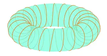

Should it be $f_{\alpha}(t)=(e^{2\pi i t}, e^{2\pi \alpha i t})$ ?
If so, sure it is a manifold when $\alpha\in\mathbb Q$ (with the proper identification it is simply a curve on $\mathbb R^2$. In this case, it is a curve that spirals around the torus until it closes, much like in the figure:
When $\alpha\not\in\mathbb Q$ the curve is dense in the torus.
Since rational numbers and irrational numbers are dense, it is difficult to say much more about what happens when $\alpha$ varies.

  • @Jonas Btw, where did you get this nice illustration? – Evgeny Nov 24 '16 at 21:42
  • Somewhere from the web, entering "geodesics" and "torus". I am not able to do it with Mathematica... – John B Nov 24 '16 at 23:25
  • Source found: http://tex.stackexchange.com/questions/70090/3d-helix-torus-with-hidden-lines – John B Nov 24 '16 at 23:35
