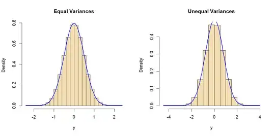

I simulated this a million times with with $X_1, X_1 \stackrel{iid}{\sim} Norm(0, 1).$ Then for $Y = X_1X_2/\sqrt{X_1^2 + X_2^2},$ I got $E(Y) \approx 0,$ $SD(Y) \approx 0.5.$ A Shapiro-Wilk test on the first one thousand values of $Y$ failed to reject normality. The histogram of the simulated distribution of $Y$ with the best-fitting normal density function is shown at left below. In this case, $D = X_1^2 + X_2^2 \sim Chisq(df=2)$.
In a second simulation with $X_1 \sim Norm(0,1)$ and independently $X_2 \sim Norm(\mu = 0, \sigma=4),$ I got $E(Y) \approx 0,$ $SD(Y) \approx 0.8.$ A Shapiro-Wilk test on the first one thousand values of $Y$ failed to reject normality. The histogram of the simulated distribution of $Y$ with the best-fitting normal density function is shown at right below.
Perhaps more help if you answer @Did's questions, and show us soon what you tried. What is your Jacobian?

  • Thanks for the intuition.By the simulation result I try to guess $Y\sim N(0,\sigma_1\sigma_2/(\sigma_1+\sigma_2))$. And it turns out to be true. – Rowan Nov 22 '16 at 14:14
  • Congratulations! And I'm fixing a small typo, that seems not to have distracted you. – BruceET Nov 22 '16 at 22:50
