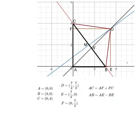

Noting first that this supposed proof actually "proves" that every triangle is equilateral because it does not distinguish at the starting vertex. I give what I find as flaw in such a “proof”.
We try the case $4$ for which the point $D$ is outside the triangle. Let $A’$ be the point at which the bisector of angle $A$ cuts the side $BC$ and let $M$ be the midpoint of $BC$.
Supposing $|\overline {BA'}|\lt|\overline{BM}|$. In this case the point $F$ should be inside of the side $AC$ while $E$ should be outside of $AB$. It is true that $|\overline {AE}|=|\overline{AF}|$ however, because of the relative position of points $E$ and $F$ in the sides $AB$ and $AC$ respectively, $|\overline {AE}|\gt|\overline{AB}|$ while $|\overline {AF}|\lt|\overline{AC}|$.This proves that sides $AB$ and $AC$ have not equal lenght (so any argument proving the contrary is false). It is true also that triangles $\triangle DEB$ and $\triangle DFC$ are congruent, however in the case $4$ at least (perhaps in the four cases I guess) it is not question of just subtraction but of both addition and subtraction.
The flaw in the argument (respect to the case $4$) is to have considered only subtraction for both sides instead of addition for a side and subtraction for the other.
In the figure below we give an easily illustrative case with the Pythagorean Triangle of sides $3,4$ and $5$ for which the bisector of the right angle is simply the diagonal $y=x$.
