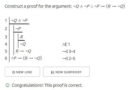

In this Fitch-style natural deduction proof checker I would have to assume $\neg P$ to derive a conditional with $\neg P$ as the antecedent. This depends on the definition of the inference rule for conditional introduction ($\to$I). Here is what that definition looks like from the proof checker's page:
To derive a conditional sentence, I have to make an assumption at the top of a subproof above the horizontal line, derive the consequent, and then I am permitted to close the subproof to derive the conditional.
Here are the questions:
I'm just wondering whether I have to assume $\neg P$ in (2), when I already have it in (1). Would it mean that $\land \neg P$ is perfectly superfluous for the argument?
In this proof checker you would have to assume $\neg P$ even though you have it as a premise. A conditional is not a claim that you know the truth value of the antecedent. It only claims that assuming the antecedent you can derive the consequent which is what the subproof showed.
Here is a proof:
Note that I only needed the premise for $\neg Q$ on line 4 because I had to derive that line. I did not have to derive the lines 2 and 3. They started subproofs each with an assumption.
Kevin Klement's JavaScript/PHP Fitch-style natural deduction proof editor and checker http://proofs.openlogicproject.org/
