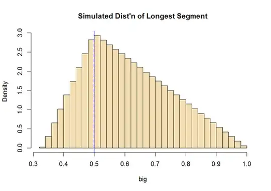

Second, here is a simulation in R statistical software of ten million performances of the two-cut experiment. The probability that the longer segment is longer than 1/2 seems to be 3/4.
I have shown details of the first six simulated experiments (rounded to fit the page). Maybe this information will help you think through the analysis more clearly.

mean(big > .5)
## 0.7501509
