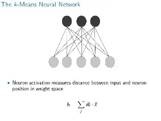

Okay so I'm doing a little bit of vector calculus at university (mainly with neural networks and the k-means clustering for cluster analysis in a 3 dimensional field or hyperplane)
And from what I understand
k means
(Forgive me I'm not sure how to format the equation with mathJax)
Is all about weights * inputs
sumof(sizeof(w) * sizeof(x)) or sumof(|w| * |x|)
Okay so the question is based on this definition:
