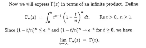

I am reading the section in Gamelin's "Complex Analysis" on the gamma function. This is on page 362:
gamma function
I do not understand how the inequality $\left(1 - \frac{t}{n}\right)^n \leq e^{-t}$ is derived.
