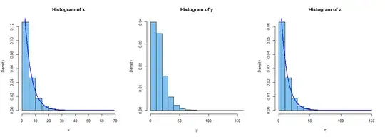

Here is an exploration of your problem using simulation in R statistical software, with some additional hints. I used $\lambda = 0.1$, so $E(S) = SD(S) = 10$ and $E(T) = SD(T) = 10.$ For a million iterations of your experiment, here are some findings (correct to about three significant digits).

Here are histograms of the simulated distributions of $X, Y,$ and $Z$. The density curve of $Exp(2\lambda)$ is a good fit to the histogram of $X.$ The distribution of $Y$ is clearly not exponential [notice the shape of the histogram and the fact that $E(Y) \ne SD(Y)$.] The density curve of $Exp(\lambda)$ is a good fit to the histogram of $Z$.
