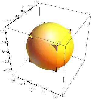

After my calculation consistently gave wrong results, I was forced to admit that the case (3) is more difficult than I thought, because as soon as the opening angle of the hypercaps is larger than $\pi/4$, they start to intersect along the edges of the hypercube, whereas the corners are still outside the intersection volume. For $n=3$, this can be seen in this graphic, which was generated by wolframalpha.
cirle-cube-intersection in 3D
Thus, the solution proposed in (3) double-counts these volumes.
