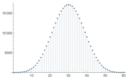

Ad Problem (b):
  • Since $x_j,1\leq j\leq 5$ may have values $0\leq x_j\leq 12$ we encode the contribution of $x_j$ via $t^0+t^1+t^2+\cdots+t^{12}$.
So, the contribution of each $x_j$ can be encoded as \begin{align*} 1+t^1+t^2+\cdots+t^{12}=\frac{1-t^{13}}{1-t} \end{align*}
Here we apply the formula for the finite geometric series.
We conclude: A generating function $B(t)$ providing with $[t^n]B(t)$ the number of wanted solutions is \begin{align*} B(t)=\left(\frac{1-t^{13}}{1-t}\right)^5 \end{align*}
