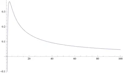

Since $m^n=n^m$, take logs and separate the variables: $$ \frac{\log(m)}{m}=\frac{\log(n)}{n} $$ This suggests considering the function $f(x)=\frac{\log(x)}{x}$.
$\hspace{2cm}$enter image description here
