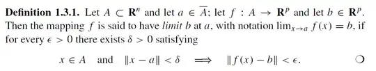

Because many of this forum may not be accquainted with def.1, you can check the book called "Multidimensional Real Analysis" by Duistermaat and Kolk, published by Cambridge University Press, where this is given as Definition 1.3.1. Here's an image of the book:
And clearly it's not a typo. (you can check the errata at the book's site.)
