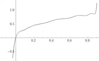

Approximate graph of inverse for small $n$:
Is there any way to simplify the boxed result or find other solutions using a series?
