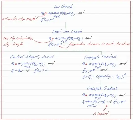

The following figure shows the hierarchy of some of the line search optimization methods for quadratic forms. Indeed, the methods are categorized based on choosing the descent direction $p_k$ and the length step $\alpha_k$. Just recall that
\begin{align} \phi(x) &= \frac{1}{2}x^{\top}A \, x + b^\top x + c,\\ x_k &= x_{k-1} + \alpha_{k} p_k, \\[0.5em] r_{k-1} &= -\nabla\phi(x_{k-1}) = b - Ax_{k-1}. \end{align}
where $A$ is required to be positive definite. Now, suppose that we are in $k$th iteration of the algorithm with $r_{k-1}\ne 0$ (otherwise the solution is found) and look at the following diagram. You should also be familiar with the following results
Lemma. In exact line search, the coefficients for updating solutions are defined as $\alpha_{k}:= \arg\underset{\alpha \in \mathbb{R}}{\min} \phi(x_{k}+\alpha p_k)$. This can be further simplified to $\alpha_{k}=p_k^\top r_{k-1} /p_k^\top A\, p_k$.
Theorem. In exact line search, if $p_k^\top r_{k-1} \ne 0$ then then it is guaranteed that $\phi(x_{k}) < \phi(x_{k-1})$. More, specifically, we have $$\phi(x_{k}) = \phi(x_{k-1}) -\frac{1}{2}\frac{(p_k^\top r_{k-1})^2}{p_k^\top A \, p_k}.$$
