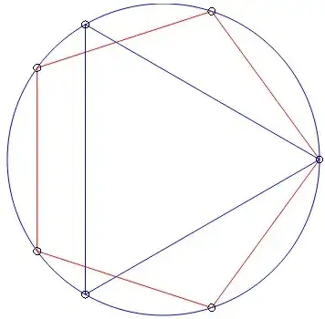

Let us take an example: consider the following permutation decomposed into the product of two disjoint support cycles
a cycle $\color{red}{(5 4 3 2 1)}$ of order $5$ and a cycle $\color{blue}{(6 7 8)}$ of order $3$.
Its associated matrix is:
$$\left(\begin{array}{ccccc|ccc} 0 & \color{red}{1} & 0 & 0 & 0 & 0 & 0 & 0\\ 0 & 0 & \color{red}{1} & 0 & 0 & 0 & 0 & 0\\ 0 & 0 & 0 & \color{red}{1} & 0 & 0 & 0 & 0\\ 0 & 0 & 0 & 0 & \color{red}{1} & 0 & 0 & 0\\ \color{red}{1} & 0 & 0 & 0 & 0 & 0 & 0 & 0\\ \hline 0 & 0 & 0 & 0 & 0 & 0 & 0 & \color{blue}{1}\\ 0 & 0 & 0 & 0 & 0 & \color{blue}{1} & 0 & 0\\ 0 & 0 & 0 & 0 & 0 & 0 & \color{blue}{1} & 0\end{array}\right)$$
Its cycle structure is reflected (see picture) into the five eigenvalues $\color{red}{e^{2i k\pi/5}}$ and the three eigenvalues $\color{blue}{e^{2i k\pi/3}}$.
Please note that eigenvalue $1$ is - in a natural way - a double eigenvalue, and more generally with multiplicity $m$ if the permutation can be decomposed into $m$ disjoint cycles.
