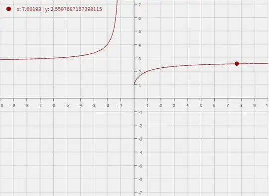

Graph of $f(x) = \left (1 + \dfrac{1}{x} \right)^x$ taken from here.
Graph
Its evident from the graph that the limit actually approaches $e$ as $x$ approaches $\infty$. So I tried approaching the value algebraically. My attempt:
