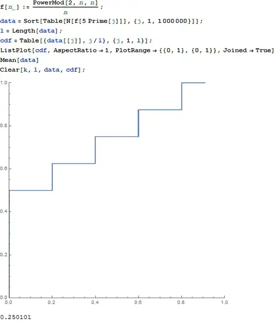

The following numerical simulation using first 1,000,000 terms of $(a_k)$ clearly demonstrates this behavior:

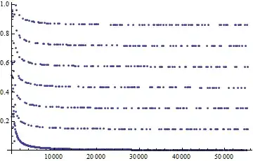

    Good job! I, too, noticed "horizontal dashed lines" at heights $k/5$, $k=0,1,2,3,4$ when I gave Mathematica the command to ListPlot values of Mod[2^n,n]/n. But I didn't get that those lines come from the case $n=5p$. – Jyrki Lahtonen Oct 14 '16 at 11:41

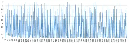

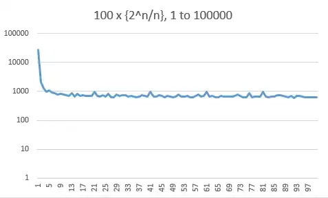

Not an answer, just for insight. Here is a plot of the $1000$ first $\dfrac{2^n\mod n}n$, to substantiate the "uniform distribution" hypothesis.

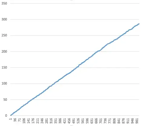

The second plot is the prefix sum, which is a straight line for a uniform distribution. The average of the values is $0.287$ (not very close to $0.5$).
Unfortunately, this empirical data isn't sufficiently conclusive.

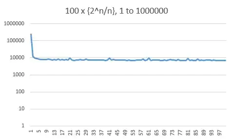

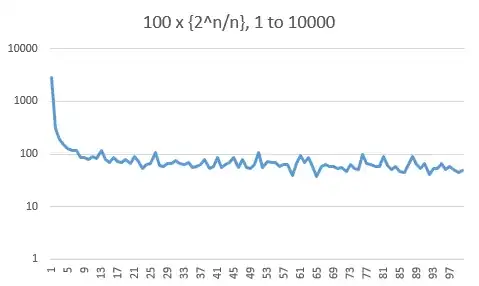

Here are histograms of the fractional part of the $10000$, $100000$ and $1000000$ first values. Beware that the frequency axis is logarithmic. There is a strong bias towards the small values (one third below $0.01$), but this doesn't seem to worsen with $n$.
I conjecture that for any $n$, at least $50\%$ of the values of $\{2^k/k\}$ are above $0.1$.

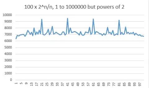

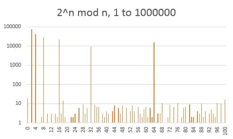

Very interestingly, the histogram of the values $2^n\bmod n$ themselves shows very strong lines for all powers of $2$.
This leads us to the next histogram, where the moduli that are powers of $2$ have been ignored. There is no more need for a logarithmic scale and the distribution looks pretty flat now.
  • Could you turn this into a histogram plot for the density in [0,1]? – H. H. Rugh Oct 12 '16 at 10:01
  • @H.H.Rugh I added a cumulative plot instead. –  Oct 12 '16 at 10:09
  • If I understand the cumulative sum correctly, the distribution seems more biased towards 0? (you mean 0.287 and not 2.87 I suppose?) – H. H. Rugh Oct 12 '16 at 10:12
  • @H.H.Rugh: right. This may reveal a non-uniform distribution as well. –  Oct 12 '16 at 10:14
  • Yes, but the average seems fairly stable (suggesting strongly the divergence in any case). There are the primes for which you just get 2/n but they are fairly rare (and powers of 2, even more rare). – H. H. Rugh Oct 12 '16 at 10:17
  • The explored range is too small to be sure about the linear behavior. –  Oct 12 '16 at 10:19

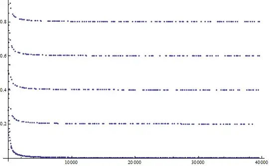

The point of this post is to give some plots that corroborate Sangchul Lee's argument. These were produced by Mathematica
The first plot lists the numbers $(2^n\mod n)/n$ for all multiples of $5$. You see the horizontal lines at multiples of $0.2$. They were already visible in the unrestricted plot, when I didn't restrict $n$ to multiples of five, but here they are easier to spot:
When we only include the values $n=5p$, the picture is even clearer:
Multiples of five are not the only structure in there. Restricting the choice of $n$ to numbers of the form $n=7p$ gives something quite similar.
