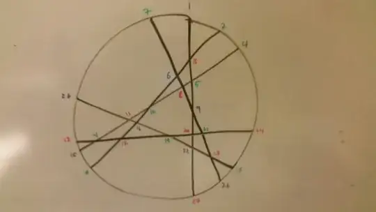

    I am interested in colouring the following family of graphs: Let $A_n$ be a simple arrangement of lines in the Euclidean plane. Circumscribe the arrangement so that all intersection occur in the interior of the circle. Denote the circumscribed arrangement by $G$. A vertex in $G$ is any point where two lines intersect or where a line intersects the boundary of the circle. Edges are defined intuitively. I claim that $\chi(G)=3$. Explicitly I know the exact number of vertices, edges and faces of $G$. I even know that $G$ Hamiltonian. $G$ is planar by definition. It is not triangle free. – Anthony Oct 04 '16 at 14:33
This did not fit in the comment section but it should give you an idea.
This picture should give you an idea.
