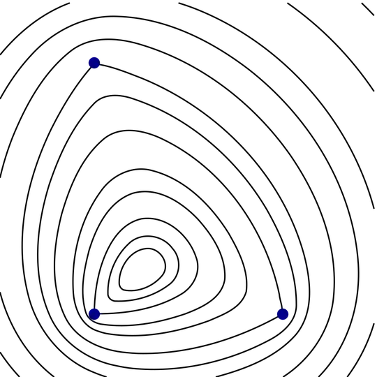

The set of points that have the same sum-distance to $n$ given points is called an $n$-ellipse. An example is shown below.
Otherwise known as the Tschirnhaus egg curve
These curves have almost nothing to do with the geometric median, except that the median is what the curves degenerate to as the given sum-distance decreases. Maxwell studied them, and we know a few properties: they are polynomial plane curves of high degree and they can approximate certain convex closed curves.
I once investigated the area enclosed by such a curve, and the results were far from simple.
