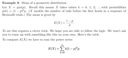

The question is about an example from Introduction to Probability and Statistics at MIT OpenCourseWare, specifically from this document.
example part 1 example part 2

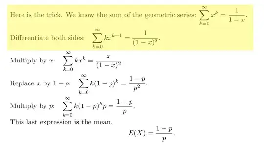

My question is, why can we do the highlighted transformation? The example is about geometric distribution, so it makes sense with $p \in (0, 1)$ and later we replace $x$ with $1 - p$, so it follows that only $x \in (0, 1)$ interests us.

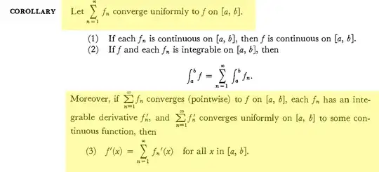

Here is what Spivak says about this in Chapter 23: Spivak - chapter 23 - theorem 3 Spivak - chapter 23 - corollary from theorem 3
This does not seem applicable to my problem, because:
  1. I have an open interval, but I can probably figure out a way around that.
  2. This is the more important point. I don't know if $\sum_{k=0}^{\infty} k x^{k-1}$ converges uniformly to anything, let alone if it converges to a continuous function. If I knew that, I would probably know what it converges to exactly and thus I would not need to use the sum rule.

TLDR: why can we use sum rule for derivating the series in first highlighted excerpt?
