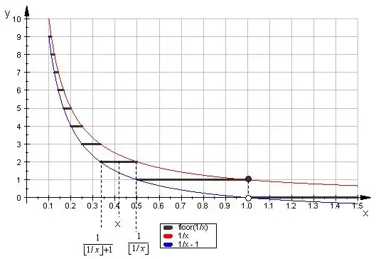

Well, in fact, your post sounds to me a bit confusing. Let me try to fix some starting points. floor(1sux)
  • As shown in the picture, $1/x - 1 < \left\lfloor {1/x} \right\rfloor < 1/x$, so the integral from $0$ to $1$ is $\infty$.
  • $\left\lfloor { - 1/x} \right\rfloor = - \left\lceil {1/x} \right\rceil$, so that, apart from shifting by $1$ and a different definition at the transition points, the function is almost anti-symmetric, and its integral is diverging also for $x \to 0^-$.
  • The integral from $a$ ($0<a \leqslant 1$) to $1$ can be expressed as $$ \begin{gathered} \int_a^1 {\left\lfloor {\frac{1} {x}} \right\rfloor dx} = 1\left( {1 - \frac{1} {2}} \right) + 2\left( {\frac{1} {2} - \frac{1} {3}} \right) + \cdots + \xi \left( a \right)\left( {\left\lfloor {\frac{1} {a}} \right\rfloor } \right)\left( {\frac{1} {{\left\lfloor {1/a} \right\rfloor }} - \frac{1} {{\left\lfloor {1/a} \right\rfloor + 1}}} \right) = \hfill \\ = \sum\limits_{1\, \leqslant \,k\; \leqslant \,\left\lfloor {1/a} \right\rfloor - 1} {k\left( {\frac{1} {k} - \frac{1} {{k + 1}}} \right)} + \xi \left( a \right)\left( {\left\lfloor {\frac{1} {a}} \right\rfloor } \right)\left( {\frac{1} {{\left\lfloor {1/a} \right\rfloor }} - \frac{1} {{\left\lfloor {1/a} \right\rfloor + 1}}} \right) = \hfill \\ = \sum\limits_{1\, \leqslant \,k\; \leqslant \,\left\lfloor {1/a} \right\rfloor - 1} {\frac{1} {{k + 1}}} + \xi \left( a \right)\frac{1} {{\left\lfloor {1/a} \right\rfloor + 1}} \hfill \\ \end{gathered} $$ where $\xi \left( a \right)$ is the fraction of the step individuated by $a$, i.e. $$ \begin{gathered} \xi \left( a \right) = \frac{{\frac{1} {{\left\lfloor {1/a} \right\rfloor }} - a}} {{\frac{1} {{\left\lfloor {1/a} \right\rfloor }} - \frac{1} {{\left\lfloor {1/a} \right\rfloor + 1}}}} = \frac{{\frac{1} {{1/a - \left\{ {1/a} \right\}}} - \frac{1} {{1/a}}}} {{\frac{1} {{\left( {1/a - \left\{ {1/a} \right\}} \right)}} - \frac{1} {{\left( {1/a - \left\{ {1/a} \right\} + 1} \right)}}}} = \hfill \\ = \left( {\left( {1 - a\left\{ {1/a} \right\}} \right)\left( {1 + a - a\left\{ {1/a} \right\}} \right)} \right)\frac{{\left\{ {1/a} \right\}}} {{\left( {1 - a\left\{ {1/a} \right\}} \right)}} = \hfill \\ = \left( {1 + a - a\left\{ {1/a} \right\}} \right)\left\{ {1/a} \right\} \hfill \\ \end{gathered} $$
So that finally
$$ \begin{gathered} \int_a^1 {\left\lfloor {\frac{1} {x}} \right\rfloor dx} = \int_a^\infty {\left\lfloor {\frac{1} {x}} \right\rfloor dx} \quad \left| {\;0 < a} \right.\quad = \hfill \\ = \sum\limits_{1\, \leqslant \,k\; \leqslant \,\left\lfloor {1/a} \right\rfloor - 1} {\frac{1} {{k + 1}}} + 1 - a\left\lfloor {1/a} \right\rfloor = \sum\limits_{0\, \leqslant \,k\; \leqslant \,\left\lfloor {1/a} \right\rfloor - 1} {\frac{1} {{k + 1}}} - a\left\lfloor {1/a} \right\rfloor = \hfill \\ = H\left( {\left\lfloor {1/a} \right\rfloor } \right) - a\left\lfloor {1/a} \right\rfloor \hfill \\ \end{gathered} $$
