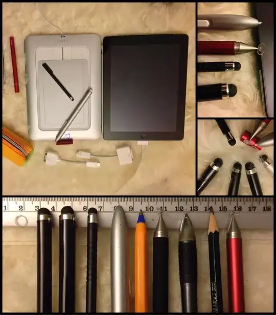

You require two things: good stylus and good app. I also like to have stand but more about apps and accessories here. Before buying any Apple product, please, acknowledge the below limitations.
Limitations
  • Linux users should check whether they can do everything they need with Chromebook and Android phone because Apple discriminates you in many things such as no iTunes support. This basically means that you cannot get backups and the use of iOS devices is very painful and slow. Some apps here such as iCab are meant to circumvent the Apple lock -- Apple makes it as hard as possible to use iPad without OS X so downloading lecture slides to iPad is a big brainy problem -- really you cannot download lecture-slides to iPad without special app (ridiculous)!
  • Low-income students should not buy the oldest OS X units because Apple stops the support after about 5 years, it is even poorer with iOS devices.
iPad for reading textbooks and writing math by hand?
In order to write like with a pen, you need either a screen-protector or a very sharp stylus. Perhaps, it is the reason why Jot and the small DX-118368 stylus here are my favorite styluses.
iPad is somewhat laggy in comparison to powerful computer with good GPU and Wacom board. Jot scratches the screen. Many imprecise bulky styluses but my favorite stylus here -- the stylus with the smallest width in the picture. If I had to choose two styluses, I would still go with a Jot stylus and DX-118368 stylus here.
The essential apps are Notes Mobile app, UPAD app, TeX Writer app, GoodReader and PDF Expert app. You can see how search over scholars and academic papers in the picture with Papers app. FrameArtist is for collegues like in this writing. Things work the best if you have iTunes and at least iPad, bottom pictures with iPhone -- yes the same apps work over iPad and iPhone. If you have to study in noisy environments, please, consider neutralizing the noise with things such as SimplyNoise white-brown-pink-noise-generator app and SHOUTcast app's CINEMIX radio, free relaxing sounds to hide noises and to help concentration -- more about silencing noises here, hope the tips and hints help your studying!

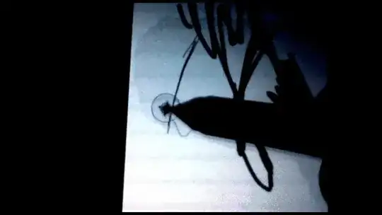

    Based on this question and answer, I went with GoodNotes, Adonit Jot Pro, an Apple wireless keyboard, and TeX Writer. I use the Jot Pro and GoodNotes for tutoring and certain types of studying, the keyboard and TeX Writer for more serious work. The combination and flexibility is impressive, and my students love it. I also recommend a Power Support Anti-glare film for protection and to cut down on glare and fingerprints: http://www.powersupportusa.com/accessories/ipad-2/hd-anti-glare-film.html Thanks hhh! – Todd Wilcox Dec 20 '12 at 23:20
  • The video is very helpful, because it suggests that writing with a stylus on an iPad, even in the best case, is not at all close to writing on a piece of paper. – Mars Mar 16 '14 at 04:15

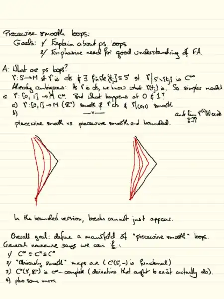

I've had my iPad for just over a year and it is now integral to my life as a mathematician. I read books and papers on it, I annotate work on it (making it far easier to comment on students' theses: scribble on it and send it straight back instead of printing-commenting-scanning), I also write my mathematics on it as well. I use it to present my lectures (when doing these as beamer presentations). And now I can even write TeX articles on it with no need for connectivity. I find it easier now to take my iPad around with me than a laptop: whilst there are things that are easier on a laptop, there are things possible on an iPad (or other tablet, I guess) that aren't possible on a laptop so I prefer to take my iPad than my laptop.
In more detail, here are the applications that I use. I can't say that others aren't good as I haven't downloaded every variant of, say, PDF reader (though I did do a bit of research into annotation but that was some time ago and applications change rapidly).
  1. GoodReader. This is the application I use for reading and annotating PDFs. Its annotation capabilities are getting better but aren't the best. However, it has various features that make it excellent for reading. One of the most useful is that you can crop a page to a particular view so the big margins typical of LaTeX documents don't use up valuable screen space.
  2. GoodNotes. This is the application I use for writing mathematics and for displaying PDF presentations. I use a stylus, and I find it quite easy to use. A stylus isn't quite as easy as a pen on paper (the resistance is a bit different), but being able to organise my notes more than compensates for that. It has a "zoom" mode which makes it easy to write with accuracy. The presentation mode is "clean" in that only the PDF and any annotations are shown.
  3. TeX Writer. There are now two applications that can TeX a document on the iPad itself (no cloud or internet connection needed). My opinion is that TeX Writer is the superior of the two.
  4. Codea. This is a programming application. I use it for doing simulations and demonstrations in my lectures.
I've written a little about this on the TeX-SX blog:
So I find that I disagree with the other answers (to date) in their caution. The more I use my iPad, the more I find that it just "fits" in with my workflow and have none of the hesitation that the others have. I don't think that it would work for everyone, but it is certainly possible that it will prove a benefit.
Added in Edit Here's some screenshots:
GoodNotes:
Notes taken with GoodNotes
Also, the annotations on my course notes this year have been done using GoodNotes. http://mathsnotes.math.ntnu.no/mathsnotes/show/lecture+notes+2011 (switched to iPad part-way through this course) and http://mathsnotes.math.ntnu.no/mathsnotes/show/TMA4115+lecture+notes+2012

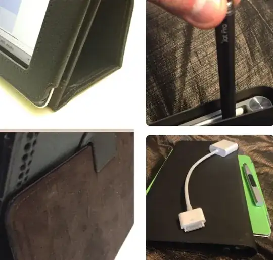

iPad is pretty stupid thing without a good stand to help reading -- it is easy to damage its covers for instance in the bag. It is annoying to read with a stand that is falling. I have tested all kind of iPad things such as SmarterStand (I don't like it) and iPad with aluminium cover-keyboard (I don't like it) -- I use iPad mostly for reading and carrying around so a good leather protector stand is very-very useful.

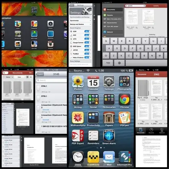

It may not matter but my apps: I have worked quite a bit to work with iPad a bit like an office but nowadays I use it mostly for reading books, newspapers, occasional server maintenance and dictionaries. Office products are still very young and hard-to-use, it takes some time to get ice-breakers.
Apps
I. Misc such as ProCreate for fast recretional notes and iCab Mobile if no OS X.
II. Documents or PDF Expert app: they have a search over all content so you can search for an arbitrary word let say in Homeworks
III. iBook for reading (I earlier used GoodReader and PDF Expert for this but not anymore because iBook/OS X far better option for me now)
Accessories
  • Protective 45 degrees' Stand to see iPad upright like here
  • Neodymium magnets here, plastic tape and Origami keep the Jot Pro attached below the keyboard, not working with Jot Classic because of lacking magnets.
  • You can create a magnetized stylus with the DX light-laser-good-head stylus 81442 and the magnets by inserting magnets above the battery container, then you get the best laser-point led stylus so far on the market and it can be attached to iPad's cover similarly to Maglus. I don't like Maglus, I like the laser-pointer-stylus much more here. I get flashlight-laser-stylus in one thing, it is very useful during lectures and in group-working.
