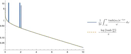

Here is a plot using numerical integration in Mathematica to confirm for $a =5$: Numerical integration of fourier transform vs analytical result
