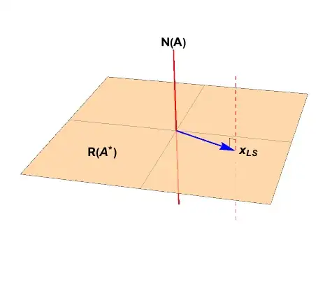

The picture shows the uniqueness condition of a trivial nullspace $\mathcal{N}\left( \mathbf{A} \right).$ The least squares minimizers are an affine space.
