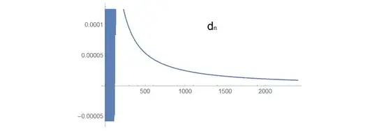

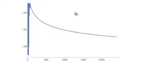

Edit
Following Winther's lead I computed the ratios of successive terms for $f_{70}$ until $n=35 \cdot 69=2415$:
$$c_n=\frac{a_{n+1}}{a_n}$$
And also the differences between the successive ratios:
$$d_n=c_n-c_{n+1}$$
We have:
$$c_{2413}=1.428347168$$
$$c_{2414}=1.428338038$$
I conjecture that $c_{\infty}=\sqrt{2}$, but I'm not sure.
  • After much effort, I computed
$$c_{4949}=1.4132183695$$
Which seems to disprove my conjecture. The nearby values seem to agree with this.
$$c_{4948}=1.4132224343 \\ c_{4947}=1.4132265001$$
But the most striking thing - just how much the sequence stabilizes after the first $200-300$ terms.
How can we explain this behaviour? Why does the sequence start with more or less 'random' terms, but becomes monotone for large $n$?

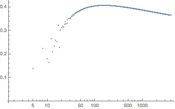

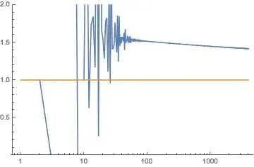

Just adding some results from a numerical computation of the first $n = 4000$ $a_n$'s in case anyone is interested to see how the sequence grows. The Mathematica code used (probably not very efficient) is given at the end. I compute $f_n(x)$ by solving the reccurence: $g_{i+1} = (x + g_i)^{n-i}$ with $g_1 = x^n$. This way we have $f_n(x) = g_n$.
Here you can see $\frac{\log(a_n)}{n}$,
$~~~~~~~~~~~~~~~~~~~~~~~~~~~~~~~~~~~~$enter image description here
and here you can see the ratio $\frac{a_{n+1}}{a_n}$

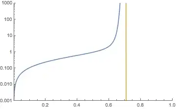

and here is a plot of $f(x)$ (well $f_{15}(x)$ however the plot below looks the same for larger $n$). The vertical line denotes $x = \frac{1}{\sqrt{2}}$ which seems to be a vertical asymptote for $f(x)$.
