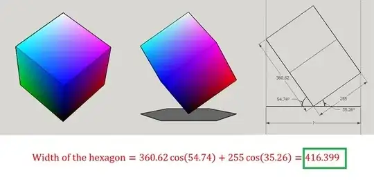

I'm projecting a cube onto a hexagon (for RGB to HSL conversion) and I want to calculate the width of the hexagon.
Cube is, first, tilted by 45° ccw on the x axis, and then, tilted by 35.26° ccw on the y axis. Black corner is at the bottom and the white corner is at the top. Both (black and white) corners pass through the z axis.
I have four values at hand, but don't know what to do with them, atm. I can get the width of the hexagon with this 3D software, but I need to be able to calculate it mathematically.

  • With the annotated angles I don't think you'll have a regular hexagon. Use $60°$ and $30°$. – N74 Aug 26 '16 at 18:03
  • @N74 These angles give the desired result. Perhaps the image I've provided or my explanation wasn't clear. I can post another image. – akinuri Aug 26 '16 at 18:21

Based on your technical drawing with measurements posted in it, the width $H$ of the hexagon can be deduced with simple trigonometry: $$ H = 360.62\cos\,(54.74^\circ) + 255\cos\,(35.26^\circ). $$
And in general, for any angle $\theta$ that you tilt the cube of side length $w$ and face-diagonal length $\sqrt 2 \cdot w$ over, the width $H$ of the hexagon will be $$ H = \sqrt 2 \cdot w\cos\,(\pi/2 - \theta) + w\cos\,\theta. $$

  • I'll be doing the calculation in JavaScript and my trigonometry knowledge is limited. How would I write 360.62cos(54.74°)? This 360.62 * Math.cos(54.74)? That doesn't give the correct width. – akinuri Aug 26 '16 at 17:23
  • @akinuri, Since JS uses radians instead of degrees, you'll first have to convert your degrees into radians. There is a function for doing this on this question: http://stackoverflow.com/questions/9705123/how-can-i-get-sin-cos-and-tan-to-use-degrees-instead-of-radians – Alex Ortiz Aug 26 '16 at 17:26
  • Ah, yes, sorry. My bad. I knew that. Working now :) – akinuri Aug 26 '16 at 17:28
  • For this particular problem, you do not need trigonometry. Just the formula $\text{(width)} = 2 \text{(edge)} \sqrt{2/3}$. – Futurologist Aug 26 '16 at 18:10
