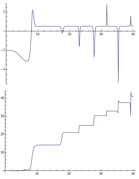

Let $h(s,n)$ be:
$$h(s,n)=\lim_{c\to 1} \, \frac{(-1)^{n-2}}{(n-2)!}\zeta (c)^{n-2} \sum _{k=1}^{n-1} \frac{(-1)^{k-1} \binom{n-2}{k-1}}{\zeta ((c-1) (k-1)+s)}$$
and let $g(s,n)$ be:
$$g(s,n)=\lim_{c\to 1} \, \frac{(-1)^{n-1}}{(n-1)!} \zeta (c)^{n-1} \sum _{k=1}^n \frac{(-1)^{k-1} \binom{n-1}{k-1}}{\zeta ((c-1) (k-1)+s)}$$
Conjecture:
The ratio $$\rho_s = i s+\lim\limits_{n \rightarrow \infty}\frac{h(i s,n)}{g(i s,n)}$$ appears to converge to the nearest Riemann zeta zero.
For $s=15$ we get: $0.5 +14.1347 i$
The plot of real part which starts off at the trivial zero $-2$ and then tends close to $1/2$ except at singularities. The Gram points appear to be a subset of the singularities.
Real and imaginary part of computed ratios
The second plot is the imaginary part of the output (ratios) which has heights close to imaginary parts of Riemann zeta zeros.

(*Franca LeClair approximation*)Monitor[
 z = Table[
   1/2 + I*2*Pi*Exp[1]*Exp[ProductLog[(j - N[11/8, 50])/Exp[1]]] +
    1/(1 - Sum[((-1)^(k - 1)*Binomial[n - 1, k - 1])/
          Zeta[k/n + 1/2 +
            I*2*Pi*Exp[1]*Exp[ProductLog[(j - N[11/8, 50])/Exp[1]]] -
            1/n], {k, 1, n}]/
          Zeta[k/n + 1/2 +
            I*2*Pi*Exp[1]*
             Exp[ProductLog[(j - N[11/8, 50])/Exp[1]]]], {k, 1,
          n}]), {j, 1, nn}], j]
Zeta[z]
(*end*)

It appears that we don't need analytic continuation to locate the first non-trivial Riemann zeta zero:
(*start*)
(*Mathematica 8.0.1*)
n = 100;(*set n=200 for more digits*)
s = (3/2 + 14*I);
s + 1/n +
  1/(1 - Sum[(-1)^(k - 1)*
        Binomial[n - 1, k - 1]/HarmonicNumber[10^10000, s + k/n], {k,
        1, n}]/Sum[(-1)^(k - 1)*
         HarmonicNumber[10^10000, s + k/n + 1/n], {k, 1, n}]);
N[%, n]
(*end*)
Output:
0.49999999999999999999999999999999999999999999999999999999999999999999\
821263876336076842104900392907 +
 14.134725141734693790457251983562470270784257115699243175685567460149\
95997175784113908425467589217131 I
$s= 3/2 + 14i \\ M=10^{10000}$
