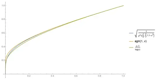

If we speak of this integral as a mean, it's very close to both Arithmetic Geometric Mean and the Logarithmic Mean:
$$M(a,b)=\frac{a}{\sqrt{{_2F_1} \left(\frac{1}{2},\frac{2}{3};1;1-\frac{b^3}{a^3} \right)}}$$
$$a \geq b$$
I remind that the AGM can be written as:
$$\text{agm}(a,b)=\frac{a}{{_2F_1} \left(\frac{1}{2},\frac{1}{2};1;1-\frac{b^2}{a^2} \right)}$$
$$a \geq b$$
And numerically we have:
$$M(a,b) \leq \text{agm}(a,b)$$
