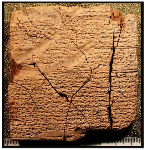

This is the computation of the weight of a copper icosahedral shell (that is, the weight of 20 equilateral triangular copper plates, all of the same thickness), done in during the Kaassite period in Mesopotamia, in the second half of the second millennium BC.enter image description here
For comparison, in modern notation we would just write something like $$20\times (\text{area per plate}) \times (\text{assumed thickness of each plate}) \times (\text{assumed density of the material}),$$ and proceed to perform the computation.
The image comes from an article in the AMS Notices, A Remarkable Collection of Babylonian Mathematical Texts.
Will Orrick
  • 19,218
  • 41
    I'm not sure what impresses me more, the fact that they were able to do this already at the time or the fact that someone actually figured out what the content on this tablet means... I guess it's a draw. – Philipp Aug 12 '16 at 08:21
    If I'd come across this I would've thought this is just an intricately designed tabloid... – user541686 Aug 12 '16 at 08:25
  • @Philipp, there is a large database of tablets to work with, of which a lot is financial records and their arithmetic. There are hundreds of thousands of known cuneiform texts spanning thousands of years, because the clay has been well preserved in a desert climate. – zyx Aug 12 '16 at 15:59
    @Mariano, lovely post, but the tablet is not a computation of the volume of the solid icosahedron. It assumes that the outer shell of a large icosahedron is made of 20 equilateral triangle copper plates, and calculates the weight of copper as the product (20 plates) x (area per plate) x (assumed thickness of each plate) x (assumed density of the material). Calculating the volume of a solid icosahedron is much more complicated than that. – zyx Aug 12 '16 at 16:16
  • @zyx, it is in fact the calculation of the weight of an icosahedron, according to the authors. – Mariano Suárez-Álvarez Aug 12 '16 at 17:46
    It is the weight of a thin shell surrounding the icosahedron; surface area of the icosahedron multiplied by a nominal thickness of the plates making the surface. Not the weight or volume of the 3-dimensional solid polyhedron. In authors' words (p.1085), "the combined volume V of the 20 triangular copper plates, all 1 finger thick", where 1 finger is considered small relative to the dimensions of the icosahedron. – zyx Aug 12 '16 at 17:58
  • 9
    @zyx is correct and I would suggest that the OP modify the answer accordingly. There is no evidence from that paper that the Babylonians were able to calculate the solid volume of an icosahedron. Rather, they only calculated the volume of its "1 finger thick" shell. – Matt Aug 12 '16 at 19:54
  • What of Earth was this o.0 Oh wait, it's a formula... – ABcDexter Aug 13 '16 at 10:16
    @MarianoSuárez-Alvarez: I don't know what you mean by "Sigh", but zyx and Matt are right: this is the computation of the weight of an icosahedral shell (according to the authors). So you really do need to modify your answer. – TonyK Aug 13 '16 at 21:19
    Why don't the people who suggested the edit just edit the post themselves? I can understand @MarianoSuárez-Alvarez's frustration -- this is a very technical point which does not change the substance of the answer at all. If you feel that the answer is in need of modification for technical details, then modify it. That is why the edit feature for answers exists. – Chill2Macht Aug 14 '16 at 16:32
    @William: it seems reasonable to give the author the chance to do it first, in whatever way they prefer (or to refute it), but by now I agree the commenters should edit — but now I’ve edited it (proposed) anyway, assuming they know what they are talking about. – PJTraill Aug 14 '16 at 21:46

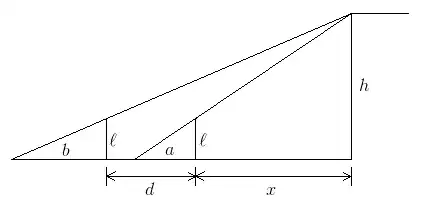

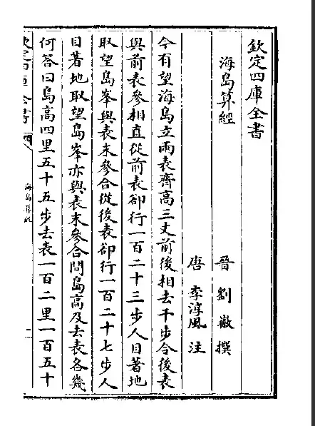

Classical Chinese Mathematics was usually presented completely using text, though diagrams and rod numerals were sometimes used. As an example, here is the first problem from 海島算經, "The Sea Island Mathematical Manual"
As with all texts prior to the twentieth century, it is written in Literary Chinese, distinguished from vernacular Chinese by its conciseness (like Latin), pro-dropness and lack of comprehensibility to commoners. There is also no punctuation, so experience with Literary Chinese is needed to read the original text without struggling. Chinese text (with punctuation) is here.
Translated:
Now we see a sea island, erect two pillars, of uniform height three 丈 ($\ell$), forward and backward a thousand 步 between them ($d$), making the rear pillar and the front pillar collinear [with the island]. Walking backwards from the front pillar by one hundred and twenty three 步 ($a$), with eye on the ground looking at the peak of the island, the end of the pillar meets [the peak]. Walking backwards from the rear pillar by one hundred and twenty seven 步 (steps) ($b$), with eye on the ground looking at the peak of the island, the end of the pillar also meets [the peak]. We ask how tall ($h$) and how far ($x$) from the pillar is the island?
Answer saith: the island is four 里 fifty five 步 tall ($h$); one hundred and two 里 one hundred and fifty 步 from the pillar ($x$).
Method saith: take the pillar height multiplied by the pillar separation as the numerator, the difference [in backward walking distance] as the denominator, and divide these. To the result add the pillar height, to obtain the island height. To find the distance from the front pillar to the island: take the front pillar backward walk multiplied by the pillar separation as the numerator, the difference [in backward walking distance] as the denominator. Divide these, to obtain the distance to the island from the pillar.
In today's notation, the result for the island height is
$$ h = \frac{\ell \cdot d}{b-a} + \ell $$
while the distance to the island from the front pillar is
$$ x = \frac{a \cdot d}{b-a}. $$
Expressing the solution is already complicated enough; I wonder how it was derived.
