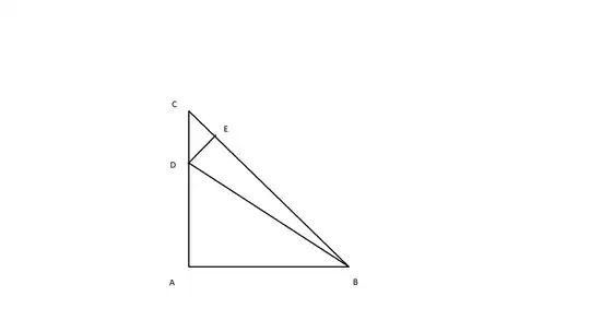

Just for fun... Adding a picture for the first time, so bear with me.
$\sin b = 1/\sqrt{10} \implies \cos b = 3/\sqrt{10}$ and $\sin 2b = 3/5$.
Now consider an isosceles right triangle $ABC$ as in the picture, with $AB = AC = 4$. Pick $D$ on $AC$ so that $AD = 3$, and $DE$ perpendicular to $BC$. $BD = 5$ by the Pythagorean theorem.
$\sin \angle DBA = 3/5$, $\angle ABC = \pi/4$, so it suffices to show $a = \angle DBE$. Now the area of $\triangle ABC$ is $8$ and that of $\triangle ABD$ is $6$, so the area of $\triangle DBC$ is $2$, and $BC = 4\sqrt 2$. From the formula for the area, $DE = 1/\sqrt 2$ , and $EB = 7/\sqrt2$ (by the Pythagorean theorem), $\tan \angle DBE = 1/7$, and the conclusion follows.
ADDED: $DE = 1/\sqrt2$ follows, more directly, from the fact that $\triangle ECD$ is isosceles and right-angled - no need for all the nonsense about areas.
