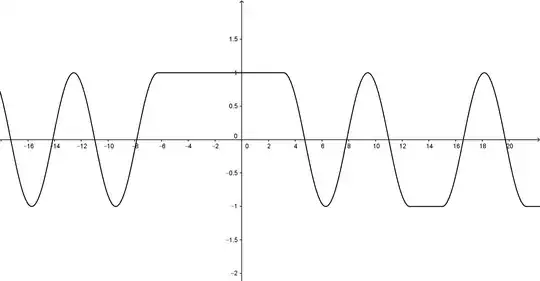

Let the curve of $y=sin(x)$ restricted
to $[0,\pi/2]$ (increasing) be called an $s_+$ arc.
to $[\pi/2,\pi]$ (decreasing) be called an $s_-$ arc.
Let a line segment of any positive length with equation $y=1$ (resp. $y=-1$) be called a $1_+$ (resp a $1_-$).
Thus one can describe the possible $C^1$ integral curves of (0) by a $C^1$ "glueing" of curves as a (finite or infinite) repetition of the following "motives":
$$\cases{1_+^*[s_-1_-^*s_+1_+^*]^*\\(1_-)^*[s_+1_+^*s_-1_+^*]^*}$$
(mathematical "grammars" notations, where exponant * means 0 or more times). See figure.
Intervals where the solution is constant may have any length.
"Phase shifts" $\varphi_k$ of the sine curves are specific to each interval.
It is to be noted that closed intervals $[b_k,a_{k+1}]$ can be reduced to a point.

1(I think) This also hints why piecewise-defined counterexamples can be found only for the $C^1$ case. (+1) – Aug 10 '16 at 12:30
@G. Sassatelli. Yes. I just provided through a graphic example an idea of the huge variety of $C^1$ solutions. – Jean Marie Aug 10 '16 at 12:54
