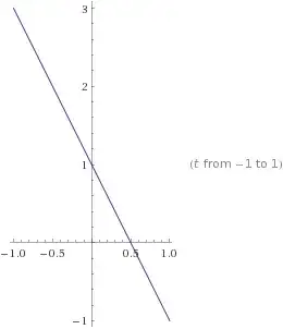

(This is merely a visualization for themaker's great answer)
Since A picture is worth a thousand words:
Think on the subset of the plane $\{(x,y) \in \mathbb{R}^2|\text{diag}(x,y) \ge 0\}=\{(x,y) \in \mathbb{R}^2|x \ge 0,y \ge 0 \}$ which is the upper-right quarter.
Take $(x(t),y(t))=(t,1-2t)$ and you wil get a straight line which starts at the boundary, then crosses it at $t=0.5$...
