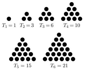

Rather than try directly find the number associated with a position in the sequence, let us instead first try to find the position in the sequence associated with a number. That will turn out to be easier, and we can then use that information as a kind of "bracket" to identify the number associated with a given position.
Specifically, how far do the $1$'s extend? Well, there's only one $1$, and it's in the first position.
How far do the $2$'s extend? There are two $2$'s, and they begin immediately after the $1$, so the last one is in the third ($1+2 = 3$) position.
How far do the $3$'s extend? There are three $3$'s, and they begin immediately after the $2$'s, so the last one is in the sixth ($1+2+3 = 6$) position.
Hopefully, you will now see the pattern. If you want to find the last number $n$, whatever $n$ happens to be, you will find it in the $1+2+3+\cdots+n$ position. Numbers of this form are called triangular numbers:
In that article, you will also find a formula for computing the $n$th triangular number directly, rather than summing up the first $n$ integers:
$$ T_n = \frac{n(n+1)}{2} $$
This formula is key to the process of finding the number at a given position. We can say, for instance, that the number at a given position $k$ is $4$ if $k$ is in the fourth row of the triangle—that is, if we write the series $a_1, a_2, a_3, \ldots$, then $a_k = 4$ if and only if
$$ T_3 < k \leq T_4 $$
That is, the number cannot be in the first three rows (the triangle represented by $T_3$), and it must be in the first fourth rows (the triangle represented by $T_4$). Ergo, it must be in the fourth row.
