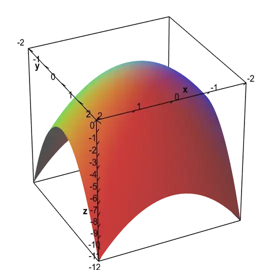

Consider the convex subset of $\mathbb{R}^{n+1}$ $C$ defined by $$C := \{ x \in \mathbb{R}^{n+1}: x_{n+1} \le -x_1^2 - \dots -x_n^2\} $$ (for $n=2$ this is the region under a negative paraboloid).
Then this is a non-compact, convex subset of $\mathbb{R}^{n+1}$, but in general it will not be possible to find a minimum on it, even for continuous functions. For example, the function $f(x_1, \dots, x_{n+1})= -x_1^2-\dots-x_n^2+0\cdot x_{n+1}$ has no minimum on $C$.
Obviously there exists a maximum, and (for smooth functions) using gradient descent we will be guaranteed to find local extrema.
If we had a function which was strictly positive then we could find a maximum, but then for $C'$ which is a suitable reflection of $C$ (namely $\{ x \in \mathbb{R}^{n+1}: x_{n+1} \ge x_1^2 + \dots x_n^2\}$) we would be guaranteed a minimum but no maxima for such functions. So I don't think that in general it will be possible to find a condition without tailoring it specifically for the given non-compact convex subset which you are interested in.
